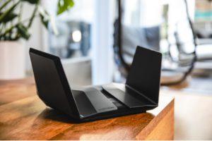

NETGEAR NighthawkAside from the increase in speed by adding more streams, the more spatial streams a router has, the more data it can send and receive from devices, with multiple streams, overall reliability and speed improving due to increased diversity. Because separate data signals can be sent to and from devices on different spatial streams, the amount of information that can be sent over a network greatly increases. Essentially, more spatial streams means more available bandwidth and less congestion for all the devices in the WiFi network.
The latest addition to the NETGEAR Nighthawk routers, the Nighthawk AX8 8-Stream WiFi Router and the Nighthawk AX12 12-Stream WiFi Router, support higher number of WiFi streams than ever before. As these next-generation WiFi 6 routers add more spatial streams and QAM to vastly increase overall network capacity and efficiency, the new standard of WiFi is ready to deliver significant improvements over the earlier generations.
