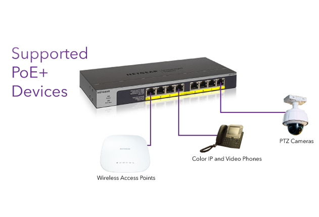

Power over Ethernet (PoE) switches use Ethernet cables to supply power to other PoE capable devices on the network, such as Wireless Access Points, IP cameras, VOIP phones, and other switches, etc. This feature allows the user to power these devices without the need for a separate power supply or the need for an electrical outlet near the powered device.
